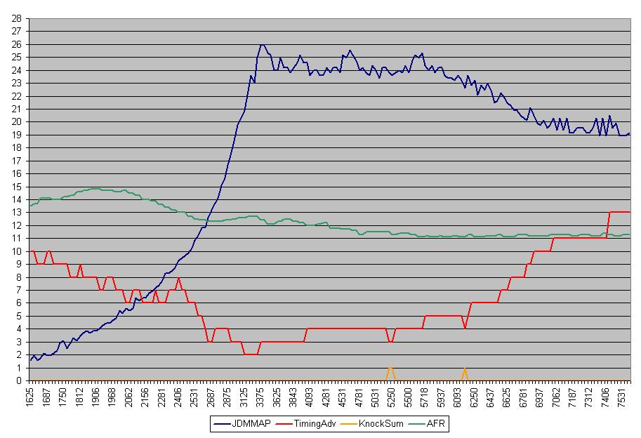

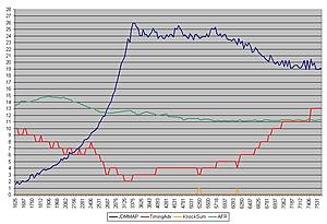

here is the best i can give you, hopefully it can help a bit.

Yeah the tune still needs more work (note the timing <100 load). A lot of it has been cleaned up these are just some logs i had from the dyno time. This tune made 290hp/320tq so it isnt all bad.
