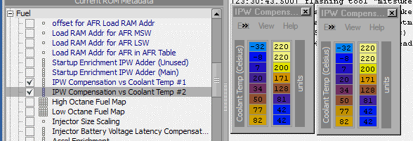

evo828 is sorta right! I was looking again this evening at the purported "accel enrichment" subroutine and realized that there is a coolant temperature compensation to IPW. There are two tables:
It can be seen though that there is no compensation after 77C, so its not the cause of the richer AFR that he's seeing.
Here are the 88590015 Evo 9 definitions if anyone want to tinker:
Code:
<table name="IPW Compensation vs Coolant Temp #1" category="Fuel" address="6566" type="2D" level="1" scaling="uint8">
    <table name="Coolant Temp" address="6fde" type="Y Axis" elements="8" scaling="Temp"/>
</table>
<table name="IPW Compensation vs Coolant Temp #2" category="Fuel" address="326a" type="2D" level="1" scaling="uint8">
</table>
Attached Thumbnails Coolant temp impact on AFR, ECU AFRMAP and subsequently - on Knock?-ipw-comp-vs-cts.gif
mrfred - thanks for the investigation - I will try to find these in my ROM - may be they are set differently. The question here is also, whether the coolant temp that I am logging (MUT10) is really the one referred in the comp table (you know we have multiple load variables - so we can have more temperature variables )
MUT10 is definitely the correct coolant temp variable to log. In all the ROMs I've looked at (7s, 8s, 9s), there's only one temperature variable that's used for controlling engine functions. Per jcsbanks, I suggest making sure that lean spool is disabled before spending too much time trying to find those tables.
