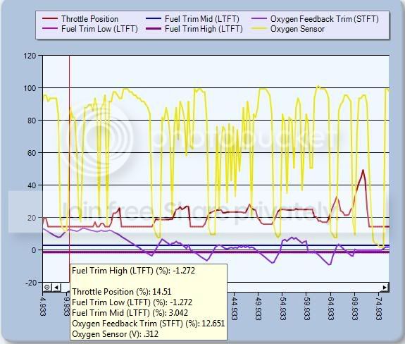

I have installed a brand new universal O2 sensor, reset the ECU and here is the result:
The car seems to be running much better and only time will tell when I get through my current tank of gas and record my mileage results.
Thanks to everyone who had helped me in this thread....
Old Sep 14, 2008 | 07:32 PM
tephra's Avatar
Joined: Feb 2007
Posts: 9,486
Likes: 67
From: Melbourne, Australia
sweet - looks good
