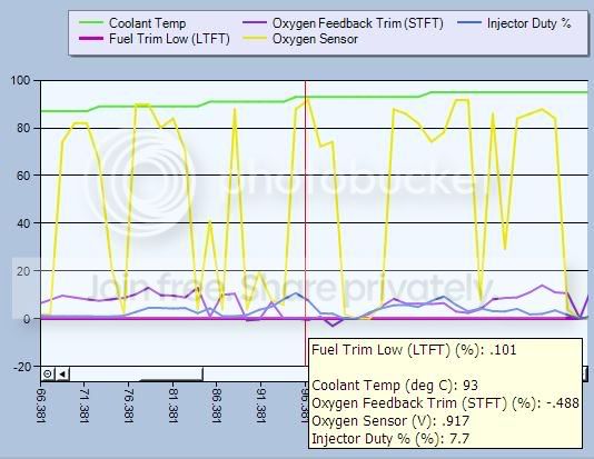

Thanks heaps Tephra for your advice! I had swapped out the two black wires and datalog the results as follows (It's now showing voltage of 0.x as opposed to 0.0x), my concern is that I've been running it like this for a while now and am worried that my o2 sensor is not as efficient or faulty now.
Here are the results from correcting the o2 sensor wires, could you analyse it and determine if it's still functional?

OK so I have reflashed my ECU with the MAF size correction to 356, crimped the
O2 wire connection, without resetting the ECU this is the data log I obtained:
Time for a new O2 sensor? Just need to hear it from the experts
Are there any other rom changes that I should be weary of since I'm running an evo 7 ecu/rom on my E6 GSR?
EDIT: Unsure if this matters but my installed aftermarket Dump Pipe positions the O2 sensor closer to the turbine housing outlet:

see how your LFTT is 12.x - thats the max value it can be.
So I would say either your injectors are not scaled correctly, or more probably your front 02 sensor is bung (excuse the pun).

What are the odds that my O2 sensor is faulty? Here's my cousin's Evo 7 O2 readings I've taken a few weeks ago.... Looks to be functional opposed to mine...
Old Sep 9, 2008 | 04:01 AM
tephra's Avatar
Joined: Feb 2007
Posts: 9,486
Likes: 67
From: Melbourne, Australia
looks pretty screwed
i mean if you had a WB you would be able to verify you are running 14.7:1 at idle...
how does the car smell when just idling? not sure how much o2 sensors are but I suspect its fuxored...
