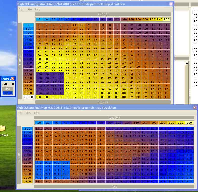

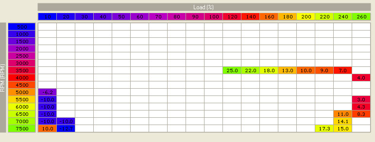

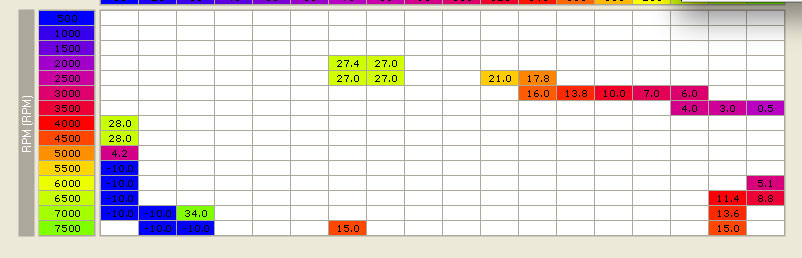

9417XXXX has only one ignition retard limit table:
<scaling name="IgnTimingECUa" units="deg" toexpr="61-x*90/256" frexpr="(61-x)*256/90" format="%.1f" min="-30" max="50" inc="1" storagetype="uint16" endian="big"/>
<table name="Ignition Retard Limit #2" category="Timing" address="173e" type="1D" level="1" scaling="IgnTimingECUa"/>[/quote]
I tried it out today. Generaly no retard below -10. In the last log I got -12.7 in only one cell. Attaching my maps and two logs. ROM is 94170015.
Attached Thumbnails Ignition Retard Limit-timinglog1.jpg   Ignition Retard Limit-timinglog2.jpg   Ignition Retard Limit-maps.jpg

I'm not looking for a real ALS right now. I just want to retard the ignition more then -10 to get the loud shots just for fun. The tables did not work for me on the 94170015, I'll try it out on the new tephra v7 96530706 with the different tables when I get back home. Any one can confirm that it works on the 96530706?
