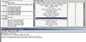

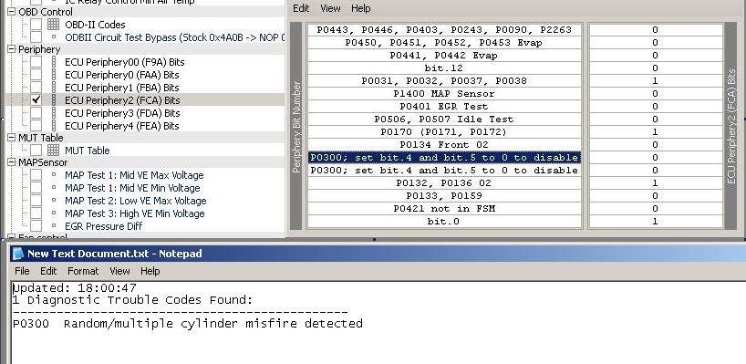

I have this disabled in my ROM, yet today got the code after doing a major service (timing belt/plugs etc). How is it possible to get the code if it's disabled via periphery?
I'll double check the plugs/belts etc, but am pretty sure it's a bogus error. The car runs fine for a while, then just dies. I've had P0300 disabled for a couple of years now and never had an issue.
