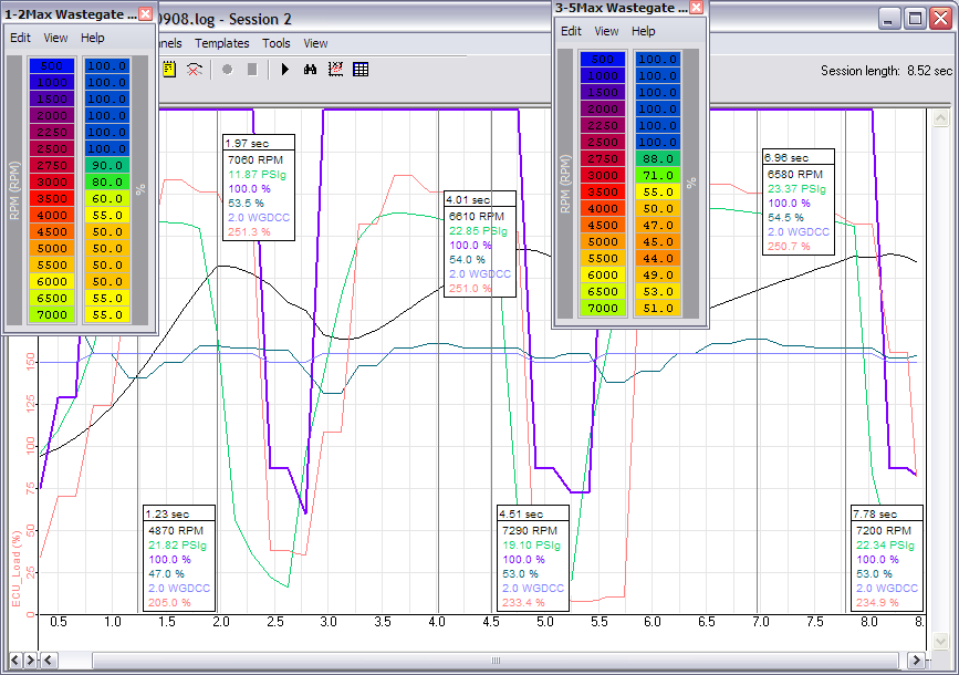

Originally Posted by Jorge T
I did read the post ...I just made an observation since I was curious to know if it had relevance since the values changed, I guess not then.
I tried this today: changed the crossover to 105 modified bdel & wgdc#1 and #3 with different values but the logged wgdc remained the same in gears 1-3
Interesting that it didn't have an effect. The algorithm to choose is based only on the crossover value. Did you try making the two sets of tables hugely different.
Gear dependent boost control is disabled on tephra ROMs. Are you by chance using a tephra ROM?
Not using a tephra ROM just a 94170008 ROM... maybe when I changed the load variable for boost control the crossover got disabled?
