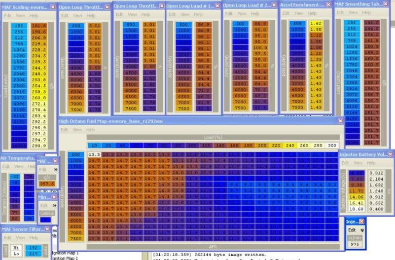

scaled my pte 1000cc's
Thanks, that helped a lot! After many hours of driving and tinkering I was able to get my fuel trims to almost zero with my pte 1000cc's:
voltage latency
4.6875 3.312
7.03125 2.184
9.375 1.632
11.7188 1.248
14.0625 0.912
16.4062 0.552
18.6768 0.408
Injector scale: 975
Fuel trim idle = .88
Fuel trim cruise = -1.2
However, my car now likes to stall during idle and when I step on the gas it hesitates. If I scale my injectors like this (below), my idle and overall drive-ability is near perfect, but the fuel trims are way off:
voltage latency
4.6875 3.312
7.03125 2.184
9.375 1.632
11.7188 1.152
14.0625 0.816
16.4062 0.552
18.6768 0.408
Injector scale: 860
Fuel trim idle = 6.37
Fuel trim cruise = -10.68
So which way should I keep, and tune by? 975 seems awfully high, but THIS IS the only way I could get my FT's to zero, and I feel like I should tune with my latencies and injector scaling correct.
Can anyone throw any pointers, or suggest other threads on how I should correct the rest of my tune since I changed my latencies and injector scale? I understand how to log and correct AFR's during WOT pulls, but not so much about fixing my idle, and correcting hesitation I have when I step on the gas. I attached a screen shot of some of my fuel settings. Sorry, I'm still new at this and trying to understand. A noob like me would like to see a thread that explains each one of these fuel maps, and how they correlate with each other exactly.
