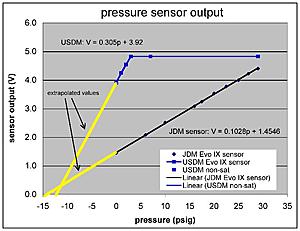

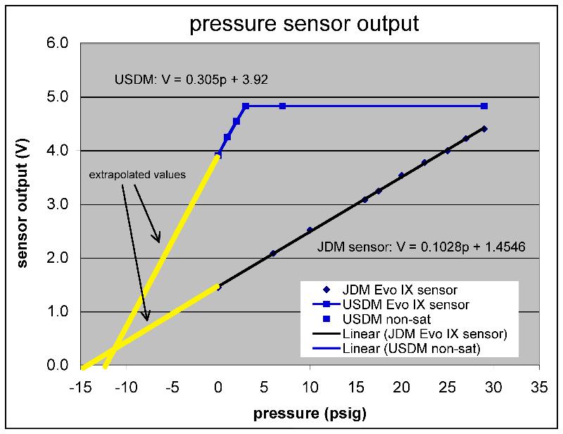

A chart like this would be handy but isnt needed:
I am sure thats right, but the thing I have noticed in the 3 bar is that saturation alledgedly happens at 3.63 volts (255). I am drawing myself a map right now, literally, and when I trace out the voltage vs Kpa plot from the pic I posted I get 4.86v at 33.2psi which is the highest I have logged (Bryan as well and I am sure others). This jives with the formula there as well.
So I am trying to decide if something in the scaling, our interpretation of that table, or something else isnt correct. I will post a pic of my graph in a second

The JDM MAP Scaling table references 3.63v as 255 yet it continues to climb.
https://www.evolutionm.net/forums/ec...tructions.html

I think I have been overthinking it. We can reverse engineer the EvoScan formula to calculate out what each value should be more or less.
Right now the 3 bar is 0.19347*x-14.5 (1 bar/100kpa)
X cannot be greater than 255
I have observed 33.2psi with that setting (coincides with my boost gauge at all points with the above scaling btw), so running it backwards:
33.2+14.5=47.7/0.19347=246.8 counts
Following the testing that Mrfred did when he came up with that JDM MAP vs USDM MDP chart and my formula a few posts back (V=0.1028p+1.456) means 246.55=4.869v
33.2*.1028=3.41296+1.456=4.8689
Setting the math to some whole numbers 4.8v/4.8689v is a correction of .9858. This times 246.55 is basically 243 (243.06)
If the Omni is 43.5psig (43.5+14.5=58 then 58/243) at 4.8v then each count is worth .238683 or so. It is advertised as linear so we can just grab a few different voltages, run the maths and apply it to the table, then check it vs a boost gauge and fine tune.
...or I have made some mistakes and we'll have to do something else

If I correctly understand what jcsbanks has learned about the MAF implementation routines, there is a fall back routine that allows the Evo 9 (with a factory MAP sensor) to run under a very limited SD mode when the MAF is not working properly. The MAP sensor scaling table that you show is the scaling used by the ECU for this limited SD mode. For some reason, the last point in the factory JDM MAP scaling does not follow the other points. Try using the second to last point in that table to set your slope, and then you'll see that things match up well.
Interesting M. I knew that 9s will run with the MAF unplugged on a completely different set of calculations. Cruise timing looks like WOT timing, it wont go into boost without going extremely lean, etc.
White, you were correct when I went through the math (or differed only ever so slightly) and all that.
I am curious though, mrfred, dont we need to know what the values are there (255 aside) so that when we log we get the right value? Or since Evoscan uses the raw ADC we just needed to know what the split was per count?
