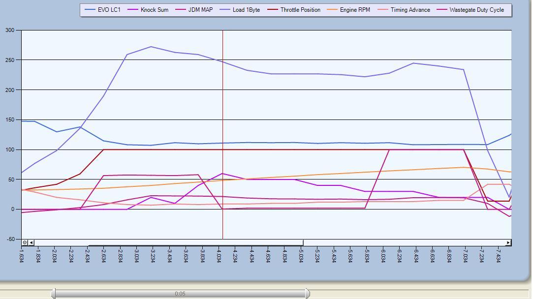

Old Apr 3, 2009 | 08:09 AM
  #323
dan l's Avatar
Joined: Apr 2006
Posts: 1,029
From: USA
Mine is fine. When boost drops load drops but my fuel maps and timing maps are set up to run wastegate boost just fine. Its a slow transition and causes no issues, only helps get rid of the knock. My AFR's stay the same and I get only slightly more timing, maybe 1-2 deg more due to slightly less load.

your AFR is placid.
