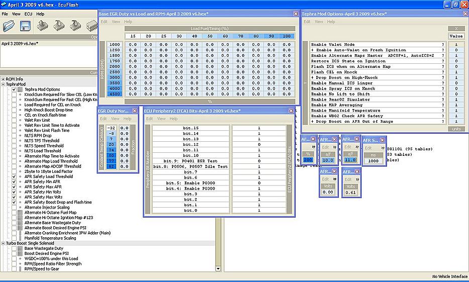

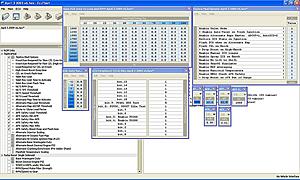

Here is my tephra mods box. I also included all my AFR settings as well as my EGR table zeroed out but it still pegs 128 on startup.........weird.

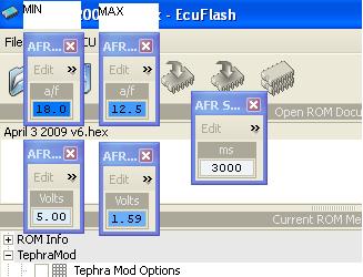

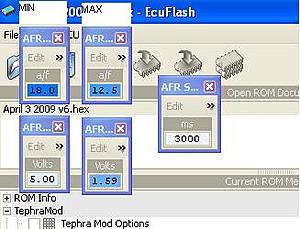

OK, got the AFR safety to work. If you look at the attached image the "MIN" values are actually the max values and the "MAX" values are actually the min value. Also it works such that if you enter the window that you set, it cuts boost. IE: the min/max values are reversed and if you are in the window that you set it cuts the boost not if you are out of the window.
Two suggestions:
I like travman would prefer 1 value. If you go over this voltage threshold then boost is cut.
Suggestion 2: a timer for the amount of time the car is above this level. What I've noticed is that I can go full throttle and play with the gas peddle on/off and get it to go "lean" during a weird transition. Its actually more of misfire probably when the BOV opens. Anyways the wideband reads lean for a small instant, but that is all the time it takes and it cuts boost, in my case for 3 seconds. I'd like a timer so that it would need to be lean for a set amount of time before it cuts boost (for me I'll use 250ms).

so you are only interested in Lean condition?
and not rich?
makes it easier I guess
I'll think about the timer thing - might be easy, might be hard..
Anything else?
This will all go into V7 - which will basically be bug fixes/small improvements from V6...

If I'm too rich thats my fault (from tuning). Too lean is a fuel system malfunction. That is the condition I want to protect. 1 number, less to screw up. However the timer adds complexity, and I hate complexity, but it is needed.
