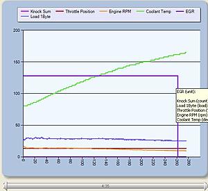

I'm going to try to attach a log I took showing EGR vs coolant temp. At 161 deg F the EGR starts acting normal. Up until that point its open.
Also tephra PM me your email and I'll send you the rom image that is in the car from the log I'm going to attach.

Yeah, today I zeroed out my EGR duty% map and I still get full EGR when starting the car up.
