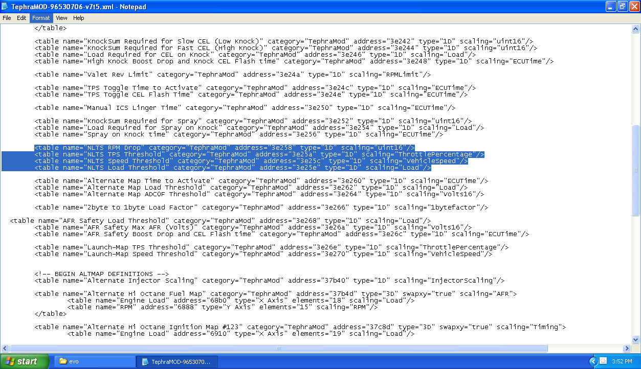

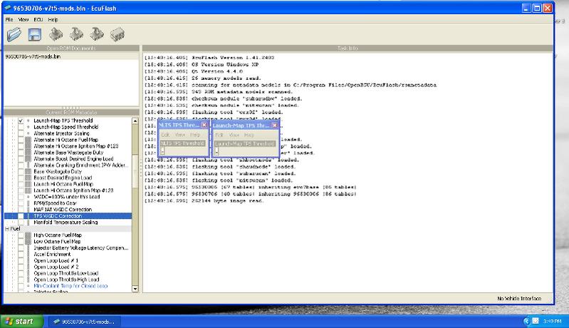

Found another slight issue and this time I tried a bunch of things (downloading fresh .xml files and a fresh .bin file) first before posting The NLTS TPS and Launch Map TPS thresholds seem a little screwy. Check out the attached screen shots to see what I am referring too.
I checked both .xml files and found everything in order (I attached screen shots of the 96530706.xml file open in the area of these too items.)
Suggestions?

Has to be something on your XML def. because I don't have an issue here. I would suggest installing a new version of ECUFlash to a new directory and placing the updated XML in that directory. I bet you will find it works perfect, that's what I had to do.
Tephra, I would agree with creating a complete new XML file, people have so much junk left over from old patches it's hard to keep fixing issues that don't need fixed, if you know what I mean.
evo8dad, that is not directed at you by any means, it's just that over the past week or so people have been posting up problems and it turns out they have messed up XML def's or didn't copy something over correctly. Just trying to cut down on that issue, one way would be to create a completely new XML def. just for this ROM.
~Zach

the above error is when a scaling is missing/wrong...
