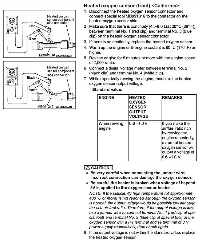

I completed the tests outlined by acamus in the above referenced post, and also those provided by the FSM by kalpakiotis (see attached doc)
My sensor was returning a 6.2 Ohm reading for pins 1&3 and the attached doc specifies anything between 4.5 and 8.0. From that I gathered the sensor was fine. Some members state the reading should be 6.0 to 20. ?
Because of the above testing behaving as though the sensor is OK, I moved to the possibility that the battery was not providing enough current at times. Start up, or when the alternator was not running the electronics due to shudder or general crappy footwork. (Its a touchy beast with the HDSS clutch at times).
This would support the weird phenomenon of the CEL staying away until such a time that I shuddered the car on poor parking maneuver.
The Battery tests show that my battery is below 12V at 11.75, when the car is not running, ie no alternator.
I am waiting to see if someone can identify when and how often the ECU checks the heater circuit of the 02 sensor and if low voltage TO the sensor (below 12V) could throw the P0031 CEL.
Edit: Acamus also suggested purchasing a universal 02 sensor at This Link
I will replace the 02 sensor at that price, 35 bucks, and keep the current low battery to confirm that it was in fact a dying 02 sensor. I will report back.

I retested everything tonight. My new 02 sensor returns a 9.3 ohm on the pin 1&3 test. Voltage is fine. So I replaced my cat and removed the test pipe, to see if that would change the behavior. Nope.
