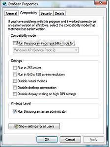

this problem is likely only on windows Vista due to its default restricted file access system. To resolve it; assuming that EvoScan is installed in directory c:\program files (x86)\evoscan\evoscan 2.5, please try the following steps:
0. Remove the short cut to EvoScan from your desktop if it's there.
1. Open windows explorer and navigate to that directory above.
2. Right click evoscan.exe to popup a menu and select "Properties". A dialog should be show up.
3. Select the tab "Compatibility" from the dialog and check "Run as Administrator". Click OK to close. See attached image for detail.
4. Right click on EvoScan.exe again and select "Send to desktop" so that you easily access it without navigate to the windows explorer again.
