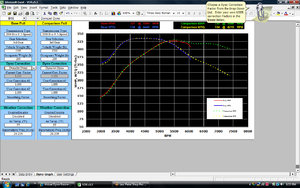

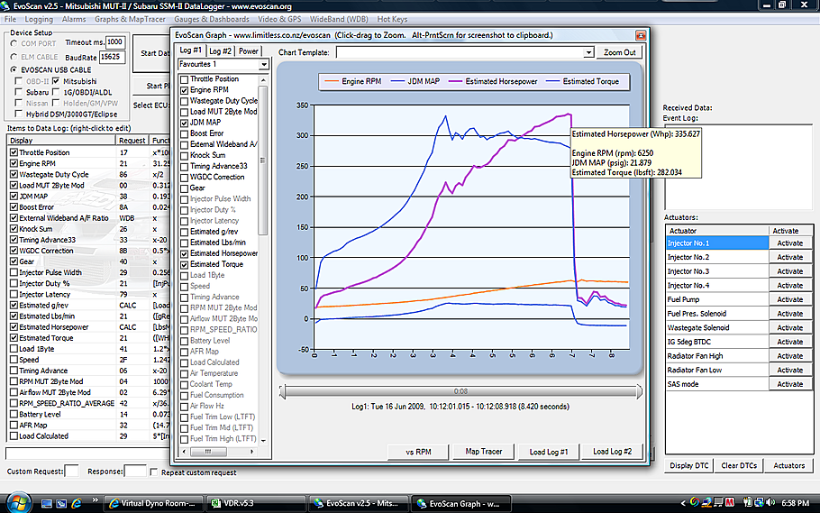

I am noticing that the graph is showing that Im running out of steam by ~ 5700, but in evoscan, it shows it shooting up... Sorry this is all I have to compare it to... I normally see ~ 345 - 350 hp (evoscan) heres a SS of the difference. I let off @ 6200, due to some1 pulling out infront of me...

I wouldn't trust Evoscan's data too much lol. Its filled with bugs. not saying that mine is more accurate with your topend power though *shrug* Maybe its not that she's out of steam but that she can take a bit more timing?? I'm an optimist lol.
So your Evo weighs 3700 lbs with you in it huh?lol Most Evo's are between 3300-3500 with the average sized driver included.
Oh, and the best way to find your tires diameter is to check tirerack.com, the manufacturers site or find an online tire size calculator.
no, 3500 total, forgot to change that back, before I took the ss...

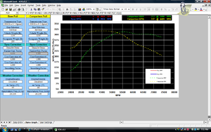

heres a SS of reality... to show how the weight of the vehicle has an effect on the output.

Jamie, the weight adjustment does not seem to be having an effect of the whp and wtq numbers.
