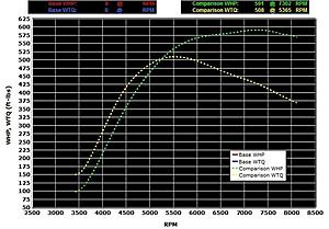

Check this out. This is my personal car with the FP-Black..
It made 601hp/512tq on our dynojet, and a street log afterwards showed...
