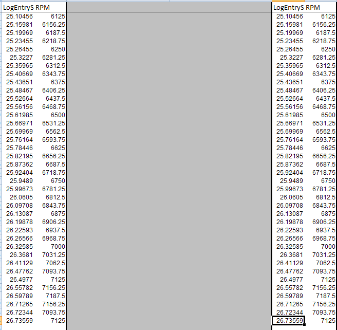

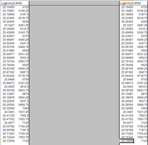

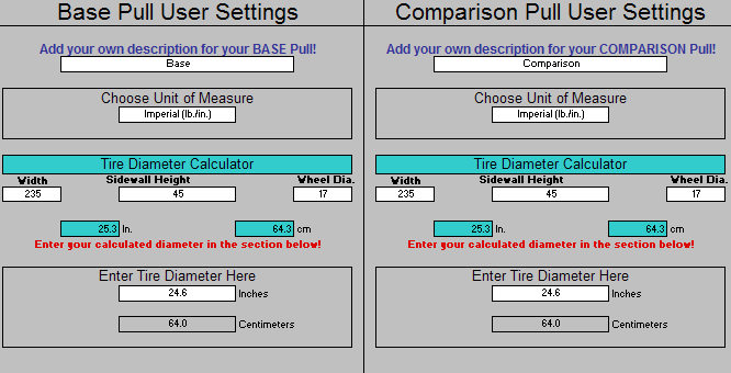

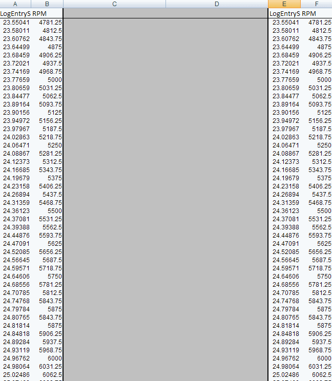

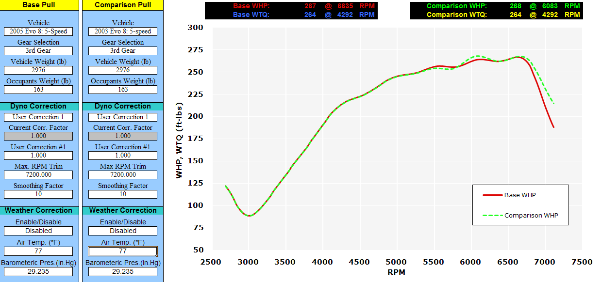

I think I found a major bug... You can make more power on the second comparison... lol was that by design! I hope not . even when you compare the same run to itself.

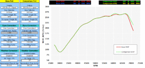

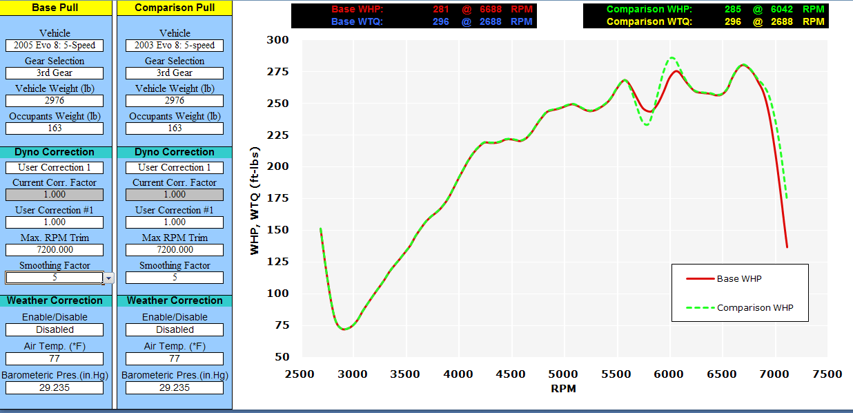

smoothing factor 5 shows the bug even worse... I guess thats the problem with using massive worksheets of formulas behind the scenes. one wrong copy and paste can make things bad.
Thanks for pointing that out Speedy . If you know how many times that program was modified, your head would spin,lol. It needs a full revamp from the ground up but since others are already working on a stand-alone version of it, I basically stopped working on it at that point. The only reason the VDR is still viable with Evoscan now having a possible working power section finally would be for other vehicle platforms that cannot use Evoscan currently. It will give a nice 'universal' freeware option if these programmers can get it setup the way they intend it to come out.
IDK if you realize this, but those
...massive worksheets of formulas behind the scenes
is what you will find with ANY power simulator...it's necessary math unfortunately. Hence why Evoscan's power section had so many bugs throughout the years too, it's quite the endeavor. I'm finally getting caught up with other projects so perhaps I might be able to revisit the spreadsheet version and clean things up a bit.
