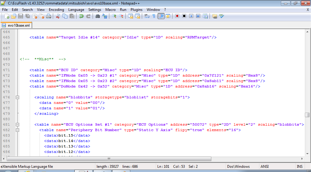

I feel like I'm doing something wrong. My rom is 52680015 and inherits from evo10base. I copied the 3 lines (IF & Do) from under 52680015 -> 52680020 and added it to the evo10base.xml under the Misc section like the picture shows. Saved and closed EcuFlash, then re-opened it. The file now shows the 3 IF and Do lines but there are 2 other things listed there.. mode 23 part 1 and mode 23 part 2 (They were there before any changes were made too). Is this right? Any help is appreciated.
Also, I read someone's comment about adding a config.txt?!? I didn't see that listed on the original post.
Update: I changed the values for IFModes to 0x23 and DoMode to 0x52 and both the mode23 parts changed automatically to enabled. See the Before and After pics attached. I flashed the ECU successfully and all is good.
