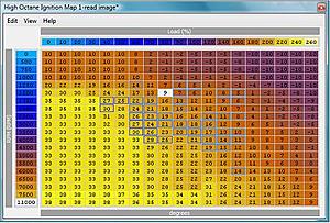

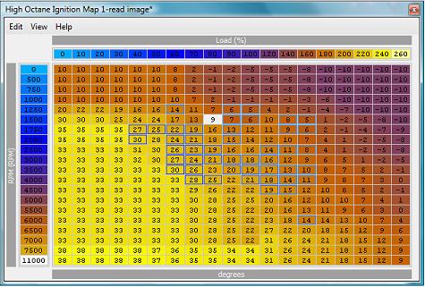

OK so heres my refined map with better transition. I havnt tryed it yet will be doing so shorty. Its close to my old map where i was getting 36 knock anywhere from 50-100 load at 2500 an 3000 cells just better transition. also i found that where the knock was happening the ecu was pulling timing like crazy, but heres the weird part i could hit the same cell an the first time it wouldnt pull any timing an i wouldnt have knock but then it would pull timing which i think is causing the knock. Same exact cells, same afr, same conditions.
Perhaps that odd pull timing bit when in open loop and rpms under 3000 like on bit 11 of the FAA periphery? Or was it bit 10? The evoecu wiki has it defined for the FAA periphery which bit to turn off.

I put the car back to normal closed loop settings and no luck the knock is still there. i did a log where i had 3 knock @ 2500rpm 80load 24deg timing, then the ecu pulled timing to 7deg and i had 36 knock WTF? how do i stop the ecu from pulling the timing behond what i have it set for as this seems to be causing the knock.

heres my high octang timing map will get the low one up soon

again the knock is always in the 2500 or 3000 cells between 40-90 loads. the ecu will just pull timing 15+ deg an knock up to 36 counts
Too much timing dude.
