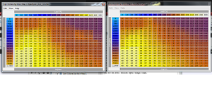

Yes it's real knock and having the low timing counts is normal for a 2.4l. Keep in mind the your going to have to adjust the air/ fuel until you get it right. But the timing should look close to this one. This tune makes 330whp and tourqe on pump gas. Also souns like you may be getting some lean spool knock you need to mess with that a bit more than likely.
Erm, what?

A 3 -> 8 * timing jump in spool/peak load? I'm not sure I would take too close of a look at those maps.
Sounds like you should go re-read the how to tune thread or take your car to a tuner for a base map.
If nothing else, no one here can tell you anything about your tune. We don't know mods, or anything else about your car. If you are knocking on the stock map you probably either have some mods that are affecting things or a problem.
Attachment 141005
Why does the low octane map have more timing advance than the high octane map? Im not an expert but shouldnt it be the other way around.
Please take a minute to look at a stock evo map the upper rpms will be lower but some will be higher. Why does a stock evo map go from 3 to -1 back to 5 at peak load..... Because thats what they felt like worked . Don't expect these guys with evo's to be able to tell you **** about a 2.4l fwd eclipse. My car came as a auto with the same engine as you. It now has evo 272's ross racing pistons eagle rods fp green turbo @22psi on pump gas and its a 5 speed with a rre 2900 clutch.
