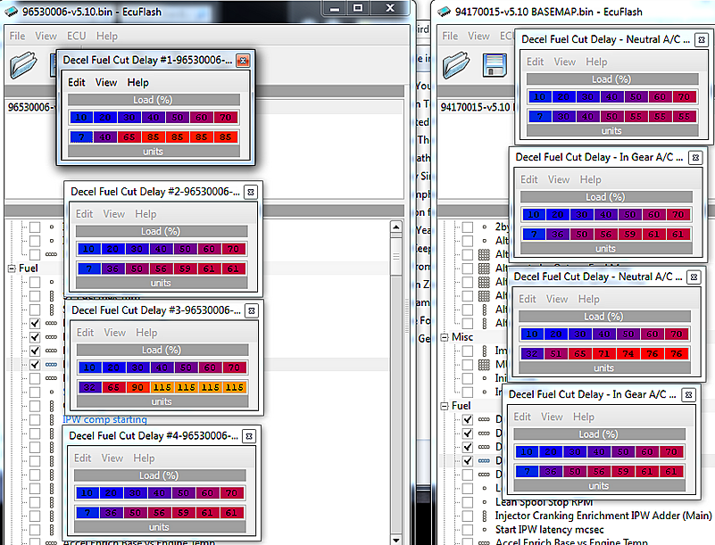

Originally Posted by mrfred
That's what I thought, but I think one person said that for the 9653 ROM, they used the 9417 ROM tables to get rid of the throttle hang, and the 9417 values are higher than the 9653 values. Thanks.
When I look at 9653 vs 9417, 9417 has LOWER values.
Old Oct 18, 2010 | 03:18 PM
  #147
mrfred's Avatar
iTrader: (50)
Posts: 9,675
Likes: 132
Hmmm. I thought I saw lower values last night in 9417. I'll take your word for it. I'll post up revised tables shortly.
