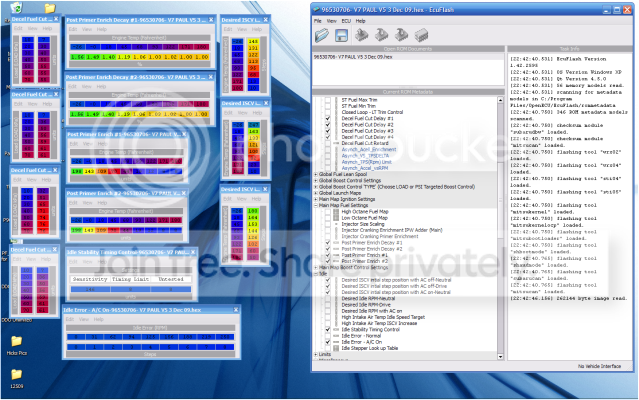

Ask and you shal be given........
If those are hard to read here is the link....
http://i480.photobucket.com/albums/r...d/Picture1.png

1. All 4 of them need to match the stock 9417 rom. See my picture above.
