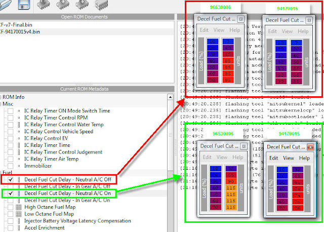

After comparing the tables the only tables that are different are the neutral A/C on and off tables. The other two decel tables are the same, no differences.
What's really the differences in these tables? Why are the Neutral tables the only ones affected and not the in gear ones? Weird....
Here is a picture of what I am referring to:

Originally Posted by mfr122887
Changed the decel fuel cut tables to match those of 94170015 and the throttle hang is still present. It is not as bad, the RPMs fall slowly but the AFRs do not peg lean, they stay around 13-14.
Try making the "decel fuel cut delay" tables AND the "Idle steppe Look up table" match those of the 94170015.
I did this and the hang is still present. The RPMs are falling but not as fast as on 94170015 and the AFRs are not pegging lean. They bounce around between 12-16 until 3-3.5k RPMs then they go lean. Anyone know why they go lean at that point and not higher up in the rpm band?
Also do we have the
- ISCV Demand RPM Adder [rpm > 4500, load > 170, speed > 12 mph]
- ISCV Demand RPM Adder (Moderated by Baro, IATS) (FFFF6EA8) (sub_204B6) [sub_1EFC0]
defined for ROMS 96940011, 94170015 & 96420008, Or did I miss something?
Do we have these table for any of those ROMS?? Since the ROMs listed above are ones WITHOUT the throttle hang, I wanna see what those tables are on them and compare to ROMs with the throttle hang.
I think a complete fix may be this.....
Making all the follow tables on 9653 the same as 9417
-all Decel Fuel Cut Delay tables
-the Idle stepper look up table
-ISCV Demand RPM Adder
Also, I think the "Decel Fuel Cut Delay Retard" should stay STOCK. I think retarding timing during throttle lift-off is a good thing.
