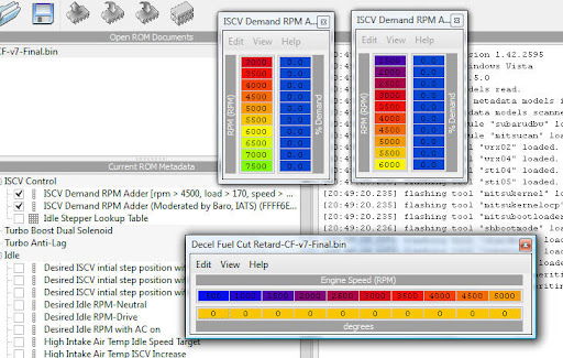

can others please confirm or deny that the fix posted by simple lancer works.
So far donor & Routybouty said it works.
If we get a couple more confirmations, then we can have the first post updated with the fix, so its easy for others to find.

*EDIT* Oops sorry got my threads confused. It was in Simple_Lancer's post:
- ISCV Demand RPM Adder [rpm > 4500, load > 170, speed > 12 mph] and
- ISCV Demand RPM Adder (Moderated by Baro, IATS) (FFFF6EA8) (sub_204B6) [sub_1EFC0]
must be zeroed out.

Originally Posted by phenem
I noticed the same, my car now doesn't hang near as bad, almost 1/2 of a second now, compared to 3-5 seconds before and doesn't go rich much 12-13 AFR then goes to normal. Here are the values I changed:
That last table is labeled "decel fuel cut retard"
Is that referenceing timing or does anybody know? The term 'retard' is usually used with timing stuff. Or is it something else?
It is timing retard.
Also i recommend leaving it at the 10 value and not 0'ing it out. Timing retard on lift off is good.
I would say try simple_lancer fix in theis thread (about a page or two back). Its the most simple, and changes the least tables. If it doesnt work, then move onto the other fixes.
I did that, zero'd out the RPM ADDER tables, and it helped alot, but is still there a bit.
