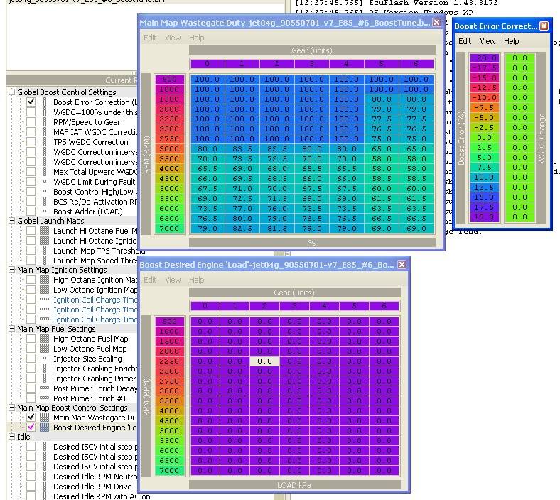

Dave, have you had anyone experiencing any issues with the WGDC being different to whats logged?
The values in the table do work, as I lowered them ~20units and it dropped boost by 6psi.
But they aren't matching up to the logged values creating a little headaches when trying to tune boost.
Using the latest XML too.
Attached a 3rd gear pull.

Anyone have any boost control issues with V7 like I do above?
Old Apr 23, 2011 | 12:12 AM
  #2306
RoadSpike's Avatar
Joined: Oct 2006
Posts: 3,805
From: Sacramento, CA
Whats your air temp reading?
There is a maf air temp WDC correction which adds up to 5% duty if the temp reaches 95F or higher. It also subtracts up to 10% if lower than 14F. Maybe this table isn't defined for you yet and it needs to be to get consistant WDC.
Old Apr 23, 2011 | 12:38 AM
  #2307
Benja's Avatar
Posts: 800
From: Newcastle, Australia.
Bingo, it was ~15*C maybe a touch lower last time I went logging.... good call.
I'm assuming I should ignore the correct that this table applies as it works seamlessly in the background, setup the WGDC for my desired targets in each gear and go from there?
Only prob is the table states it should pull -1.0 at 15*C, at 6k the WGDC should be 73.5, however its logged at 79.
Its 5.5% WGDC higher for every point throughout the pull exactly.
edit: Appears to be defined in 90550701, however its like the WGDC table or something is incorrectly defined.
That table will use the scaled value, what is logged, so i'd go by that. Maybe you can adjust the table based on how sensitive the turbo is to change. For my fp red i used a max correct of +2% and -2% for the extremes since I wanted very little change in WDC even in extreme weather.

No dramas, stock 9.8 rear turbo, on stock dump and stock piping, so turbo takes a fair bit of %DC to get it to change. lol
