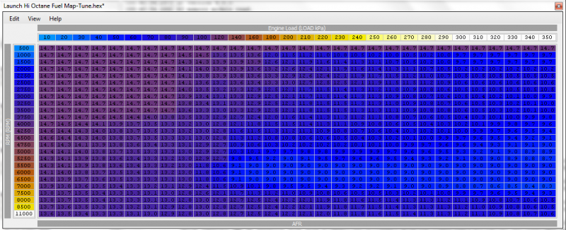

So I'm gonna open this thread back up. Recently got into messing around with EcuFlash and I'm just curious to how everyone thinks my launch maps look. This was a pretty helpful thread so why not bring it back up!
Builds about 12psi
2-Step: 5812 rpms
TPS Threshold:90%
3076R
FIC950cc
SparkTech COP non cdi
etc...
Just curious to what everyone has to say. Thanks!
