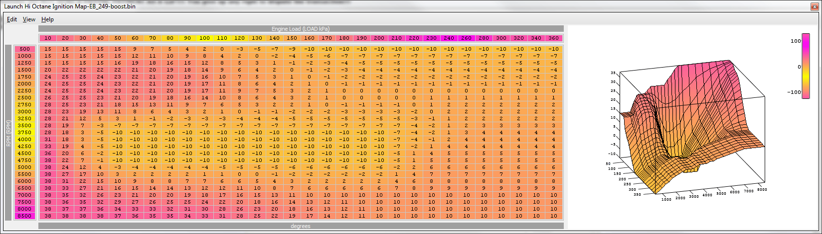

Sorry, I'm a bit late with my reply but I never noticed your message. At the track I don't use launch maps, just the regular 2-step at 5k because I'm on stock clutch and don't need more power as it is. Just for kicks I'm testing out launch maps at 4.5k at -10 degrees.
Originally Posted by wizzo 8
So if you are knocking on the 2step Im assuming this is not normal or good. I lowered my timing and it made it better but didnt go away fully. I have timing at 10. Im assuming I need to get closer to 0
Try to make a smooth transition, and also keep in mind you'll be on your regular timing map until you pass the various thresholds to switch to launch maps, so even if your transition is perfect in your launch map, you might stay on your regular map for a while and be causing a big jump when it switches. Usually I don't get very much knock when I try out launch maps. See my launch ignition map below.

Here is my current launch map
It worked great on stock turbo and stock injectors. Now I have bigger injectors (PTE 1200) and It is really hard to launch using the 2 step, I'm flooding the engine and it bogs.
Shouls I lean it out, add timming or both?
Thanks for your reply

I would just start by leaning it out.
