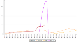

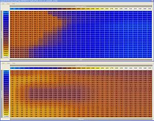

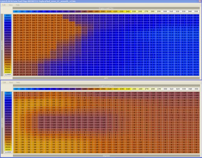

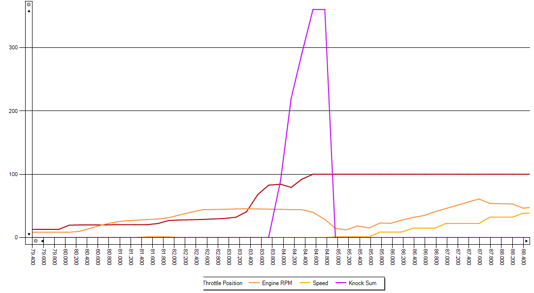

ok, just started playing around with launch maps so bear with me.
I adapted raptord's -10 block, targetting 4500rpm stationary limit, and interlopolating up/down/all around.
used the fuel map from my high octane map.
Then i pulled some logs. From what i get out of it, i hit my -10 block, but from there all hell breaks loose. i am building boost 10psi-15psi.
you'll see from the graph, that's when i get 20+ counts of "knock". I think this knock is really just the backfire. as soon as the car starts moving, the knock goes away (on the graph). that said, the car bogs the heck down before transitioning to the high octane graph... i experimented with putting AFR to 10.0 in the fuel map and interlopolating, got similar results. what am i doing wrong here?
Time Seconds TPS RPM Ign Speed Knocksum
02:55.0 57.9168 51.7 4531.25 -10 0 1
02:55.2 58.11887 55.2 4531.25 -10 0 0
02:55.4 58.31894 73.7 4531.25 -10 0 6
02:55.6 58.51588 88.2 4500 -10 0 20
02:55.8 58.73292 100 4500 -10 0 33
02:56.0 58.92753 100 4000 -10 0 32
02:56.2 59.12962 100 2593.75 -10 0 32
02:56.4 59.32603 100 1750 4 0 0
02:56.6 59.54418 100 1562.5 8 6.21 0
02:56.8 59.73867 100 2250 6 6.21 0
02:57.0 59.93567 100 2187.5 5 6.21 0
Attached Thumbnails launch maps-revo_launchmap.jpg   launch maps-timing_vs_knocksum.png   launch maps-tps-engine-speed-knock.png
I never actually launched my car with the launch maps I posted, I only made them to unleash the ricer that's hidden away inside me and see some flames , so my map may or may not actually work once you start moving.
lol gotcha - what have other folks done to deal with the knock issue? From the logs it looks like it'd be getting 10.0-11.3 AFR fuel wise. Given the load readings that are taken from the 1byte (though i'm not sure if they're accurate or how they are taken - 320 load on launch? is that normal?! i guess that could make sense with tps 100% rpm 4500, and boost between 10-20psi?)
is there a way to tell the system to ignore knock on launch?
