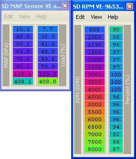

I no longer use 1:1, it has drifted somewhat. I think I have it posted somewhere else around here but the main changes are a little less at idle and cruise (i.e. 61-->57) and out the top it seems that all turbos have worked well with 340-->430.
You guys have a little different tuning style of SD than I do. My style matches more of what John had when he introduced this.
You can see the trends if you multiply your maps out into a 3D chart in Excel or something.
VE is going to be a lot less for map under vacuum (part throttle) than during 0 vac/boost (WOT). So, for my map ve tables. It tapers way down at lower vacuum ranges, then to 1:1 ish at WOT. It makes for a much better correlation to what the VE was when on MAF.
Of course 2 2-D tables aren't perfect for trying to capture a 3-D chart, but if you multiply them out, you will get what I am trying to say.
Edit: Here is what my tables looked like, so you see what I am saying. This is of couse on a stock turbo, with stock exhaust, so VE falls at the higher RPM:
