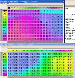

Ok so im trying to understand whats going on in my tune here to better asses things and maybe later on play around with it a little and retune myself.
In the timing map the 3x8 section of cells with negative numbers at high load and sub 1k RPM whats going on here? When would the car actually hit these cells? Also after reading the how to tune an evo thread like 200 times and still counting Ive always read to make smooth changes between adjacent cells? I see -8* to 9* timing in adjacent cells etc. Im sure theres a reason for this im just curious of why?
Also the low load and low RPM area I have a section of cells that all have 14* timing. If i remember from a while back the stock rom had more like -14* timing in this area and it wasn't so large. Ill assume this is for the cams I put in? (GSC S2's) How does this massively increased timing help my idle? I didnt notice much of a difference. I mean its lopey wich i dont mind...but it was lopey before too.
What about the two cells of 8* timing at 0-10 load and 1250 rpm. Also for idle? Why the difference?

EDIT: oh just in-case anyone was wondering. I changed the color scheme in EcuFlash to this somewhat "flamboyant" one because it was much easier to see from a screen shot. The factory set one was this super dark blue that you couldn't see the higher timing numbers or lower AFR number very well. That is all....

If I had to guess it would be pretty rare for a car to ever hit those load cells at idle, which is why they were basically "ignored". In looking back at my logs my load at idle is 30ish pretty consistently.

Not really sure about those 8's, 12's, and I think those are 13's. I don't know why they aren't smoothed up from the 14's. Kinda weird.

Yup those are 13's sorry for the crap quality. Im not sure of a better way to take a screen shot of those.
The 1250 row reads 8 8 12 12 18 22 22
The 1500 row reads 13 13 19 19 28 26 25
In case there is any confusion....
I thought that was kind of weird too but im just learning so I was unsure what the reasoning is behind that.

I would guess those 8s are the result of somebody not looking very closely at what they were doing. The stock map has lower values (5) around idle, then smoothly transitions as RPM go up. It looks like the big block was set to 14, but the boundry wasn't smoothed appropriately.
It's not really a problem because 1250 RPM idle at 10 load is coast down with the throttle closed. The injectors are probably shut off altogether so it hardly matters when the coils fire.

any comments or information on the timing being +14* compared to the original -14*?

Yeah I've seen similar, I had an email tune before I knew anything about tuning. I'm no expert by any means but when I took a closer look at it, I saw there was a spike where the tuner pasted part of one map on top of another and forgot to smooth.

I looked at this and to sum it up, I wouldn't go back to this tuner. The map looks very sloppy, and not smooth.
take a look at the map in 3d the timing should advance smoothly up to about 100 load, or where spool up begins, then it should start smoothly tapering off to peak load. looking from Left to right.... looking from top to bottom, it should generally advance as rpm increases. The reason I say look at the 3d map is because if there are jagged peaks, or what I call cliffs, abrupt increases for one load line to the next, it will show a sure sign of an issue with the table.
I take it a step further when I do my car and graph everything in excel and use trend lines to calculate what I think the "cells you will never reach" should be so the whole map is as smooth as it can be and looks like a rolling hill rather than a jagged cliff edge.

I would have to agree with this. I still don't understand how some of these tunes are actually paid for. This looks like an older Dynoflash tune where he block tunes half of the map. Look at that sea of 6s...it used to be a sea of 8s.
Obviously, this was just a quick and dirty, slap a tune on the car. I don't know who this tuner was, but maybe next time go to a tuner that actually bases your maps off of your logs and then knows how to tune the adjacent areas of the map that your log may not have covered.
There is no negative timing on the stock ignition map from 90 load and below.
Stock ignition map on Evo 8:

Bryan thanks for the stock Evo 8 timing map. Clears a few questions.
