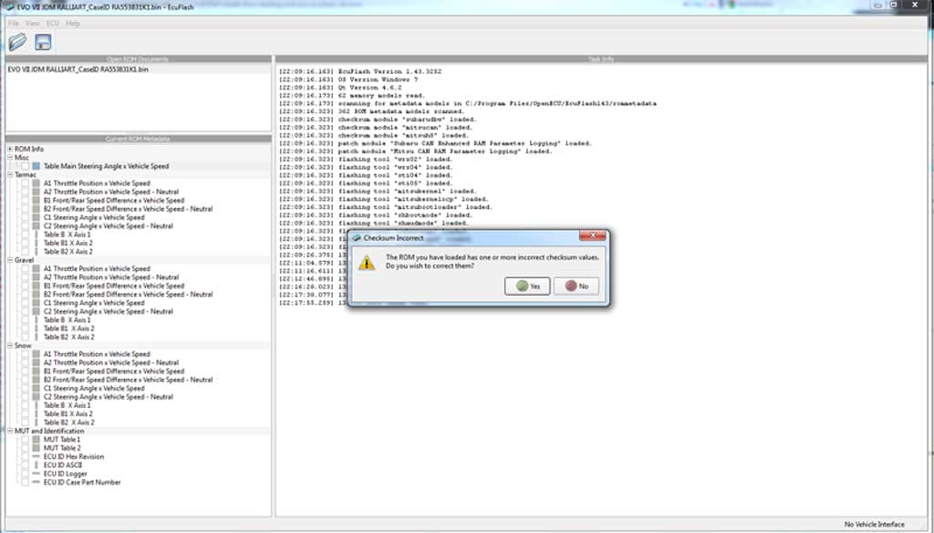

Break-thru: Reading ACD ECU with EcuFlash
Where is the problem? I have problem with a RA ECU K1.
https://www.evolutionm.net/forums/at...1&d=1307996435
Attached is a diagram I used to connect up the flashing cable. I got the ECU plugs from an old loom, this was cut about 10" I had to cut one of the spare connectors out to use for the lead coloured yellow. I then used some simple cable crimp connectors to connect the OBD II female to the cigarette lighter adapter and to the ECU plugs. I had to use an ohm meter to locate the correct wires on the ODB II conector.
ODB II Female
Cigarette lighter
ODB II Female
Cigarette lighter
just wont to be 100%
I have done It !!!! THANK YOU lan_evo_mr9 for the harness. I HAVE FLASHED MY ACD ON MY EVO 9 MR. IT WORKS !!!
