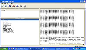

So I made a flash cable and pulled my ROM, but this is all I got. Am I doing something wrong here? I don't have any of the maps showing up.

You don't have a proper definition file.
Post the rom so someone can work up a def or at least identify the rom version.

Here you go Merlin. I have a 2006 IX SE, but the ROM says its 2004. Is that normal? I was able to flash the ROM you had posted in the other thread and read it from the ACD ECU fine, so I think I have the flashing down. Let me know if you need anything else.

Siluck2, thats strange. The rom is a 401702, which I have previously only found in JDM Evo7.
I have not revised that xml since March 2010, so its a bit out of date. I will do some revisions and post an xml.
