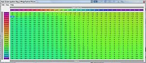

Hey Guys,
Check out my timing map and see what you think.
Boost is about 20psi pike dropping to redline.
Problem i have is in first or second gear and i punch it from about 2500 i get knock counts, if i do the same pull in 3rd or higher from 2500 i dont.
Also its not every time this happens in first or second maybe every other time.
Ive really tried taking timing out of the trouble area with no change, same issue.
Fuel is 98oct here in AUS.

how much timing did you pull out and what load are you seeing on the pull. at least with that info i think someone can chime in.

I think a log would help a lot more than a timing map, as we have no way of even knowing where you are on the map.

too much negative timing and probably rough transitions....

Honestly, I would pretty much start over with your entire timing map and take one of the published starting points posted on this site. That said, if you want to try adjusting yours :
(1) take values in the column 140 load from 2500 - 11000 and copy those values in the 100 load column
(2) then smooth from 100 to 350 (I doubt you ever come close to 350), but you should not need to go negative (from your logs it looks like you hit 240 peak, so maybe rescale to 300....)
(3) try to limit your cell to cell changes to no more than 3 degrees (ideally 2 or less) in the sensitive areas
(4) after you do that, I think you'll be able to lean up your AFRs in the spooling up area
Good luck

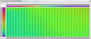

Ok so i tried what was suggested above and it made it a whole lot worse.
See my adjusted Timing map attached and the log for it
It seems my first timing map was better

Now you have smoothed out, I suggest you start to retune. Start pulling timing out where you are knocking.
Remember, you need to keep it smooth.
Your original timing map was not smooth. It was all over the place. Changes in timing were too radical.

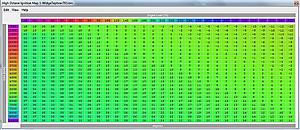

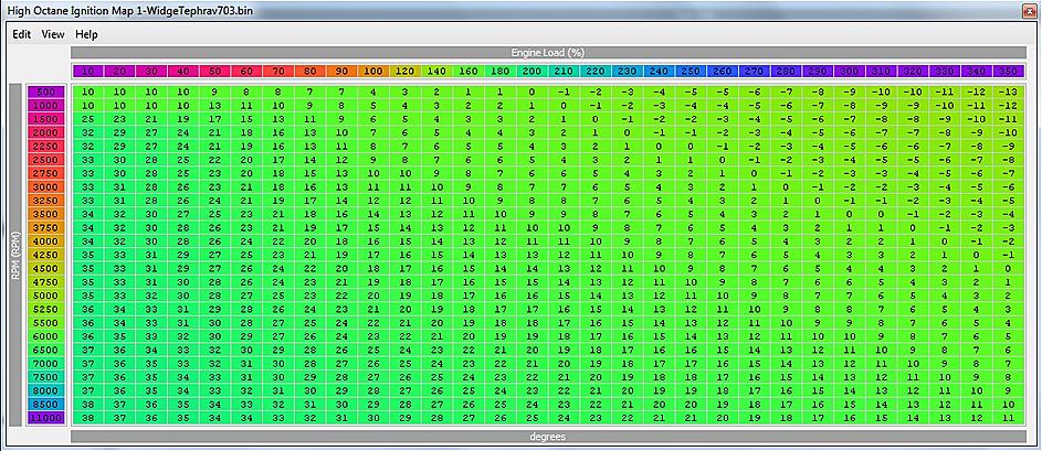

Ok i think its fixed,
See my current timing map and logs attached, heaps better
Let me know what you think

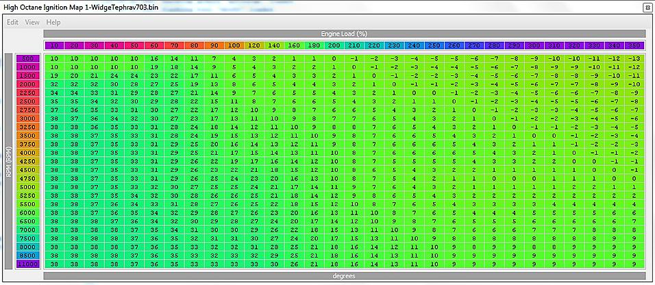

Just a suggestion, you are running big maps so why not take advantage of the extra resolution available to you ie. you are hitting around 250 load max so scale to 270 load or similar, also check your timing its not very smooth at all especially from 240 load upwards
See my timing map for example
