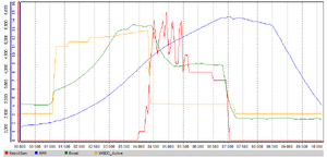

So I got this idea of implementing a failsafe on my car from AEM Wideband Failsafe and Tephra XMod v2. It's just a matter of a few hacked line on my current Tephra Xmod v1 ROM. In my case I modified the code so that if I get knocksums that would trigger CEL, that ECU should also dump boost. To do this, I introduced to a third custom table, called failsafe BWGDC that's entirely filled with zeros. This table doesn't come into use until knock CEL, allowing me to continue to run full dual maps.
To test this meant not having to sacrifice my engine. I just went into the Knock Background Noise Multiplier table and set 4500-8000 RPM to very low values (make knock detection hyper sensitive). This will trigger big knocksum that's all false. Did a pull from 2K and right at ~4500 hear my DV go a pshhh followed by a noticeable loss of power. Here's what happened in log form. Right around 4250-4500 RPM, big false knock, followed by immediate drop of WGDC. Not shown is MAF taking a near stairstep dip (within 60ms) while MAP takes slightly longer to bleed charge pressure down to WG spring pressure (within 700ms).

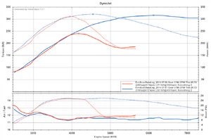

And here it is overlaid with a normal pull. BTW, the rising AFR on the failsafe plot tracks exactly AFRMAP as it would be in those lower load areas.
I don't know if this is something others might be interested in. Let me know.
