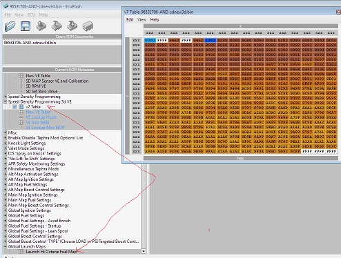

i've started to copy over my rom settings so that down load over the weekend and try but noticed that the v7 table in the Speed Density Programming 3d VE section changes the values in the launch map, is it just a error in the xml? or do you use the launch map area?
Also is there an easy way of converting my 2D VE tables into an initial 3D one
thanks
thanks
Its changing something in the launch map?
I'll have to look at the roms and find out but it shouldn't

hi yeah the ones i've highlighted in the screen

Ah I see don't worry about that. I put that table into the xml as a quick way to make a new table in some other part of the rom. I used the launch fuel map table as my guide to copy into a new space into the rom.
Don't worry about things in the programming part of the xml its really just left there for other programmers to see what i changed and where.
