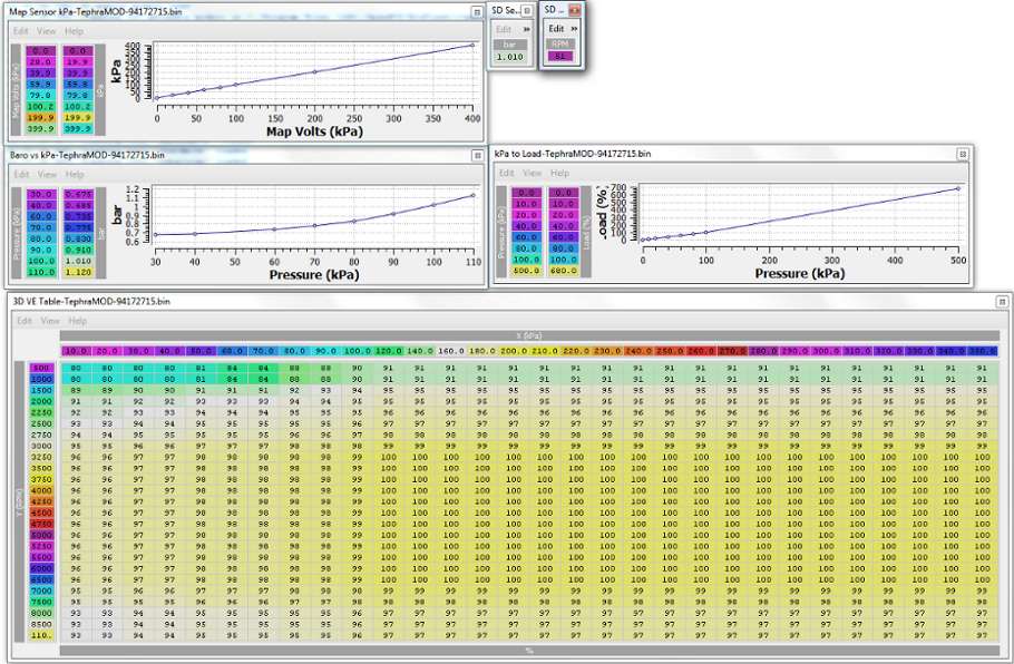

Thought I'd make a new thread instead of cluttering up John's
This isn't really for discussion if this rom works its simply done and the rest is porting it over to new ones. I can't test this myself as my evo is gone :P
Should be a straight forward test will work or wont
9417 Variant:
http://www.megaupload.com/?d=OHSFQUIN
9563 Variant:
http://www.megaupload.com/?d=4CAOEDQ8
I'll patch in the others once i get some confirmation the rom actually runs a car. Its a lot more tedious to patch now that I'm completely rewriting the SD sub from scratch to handle these new load points.
New Table JPG:

Very cool. Any tips on how to expand the values in our 2, 2D tables into the 3D table? I think I remember some discussion in the SD 2.0 thread, I'll take a look there too and see if I can get this working.

lets get some screen shots of what it looks like.
