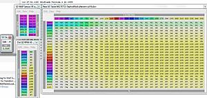

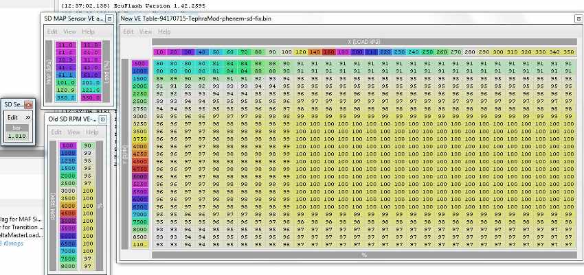

Did find an error in my xml I was looking at the map sensor table and wondering why banks left all this space in the map determined later it was only able to use 8 spaces but i forgot to put it back.
NEW XML with correctly map sensor table.
Picture of the new ve table compared with old one.
