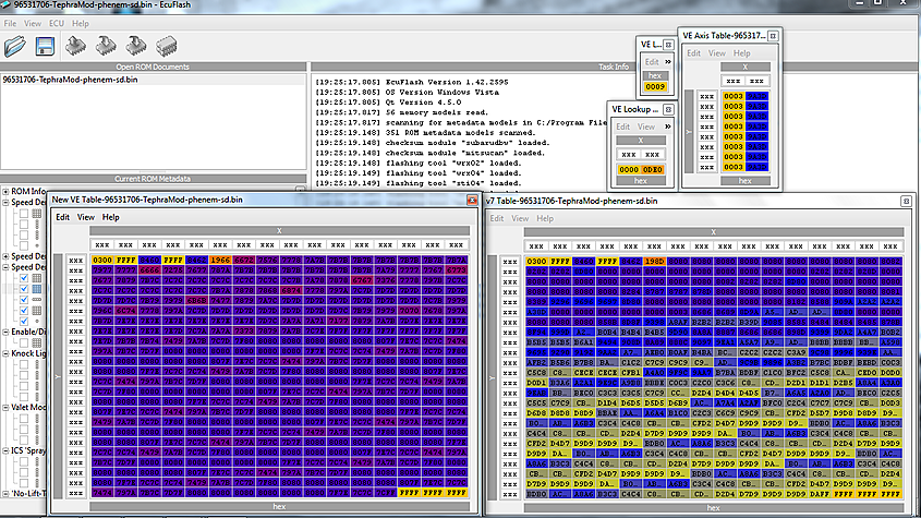

I noticed that in the "Speed Density Programming 3d VE" that the addressing looks incomplete. I have attached a screen shot to show this. If everything is good to go then I will transfer all of my setting over and try this out.
