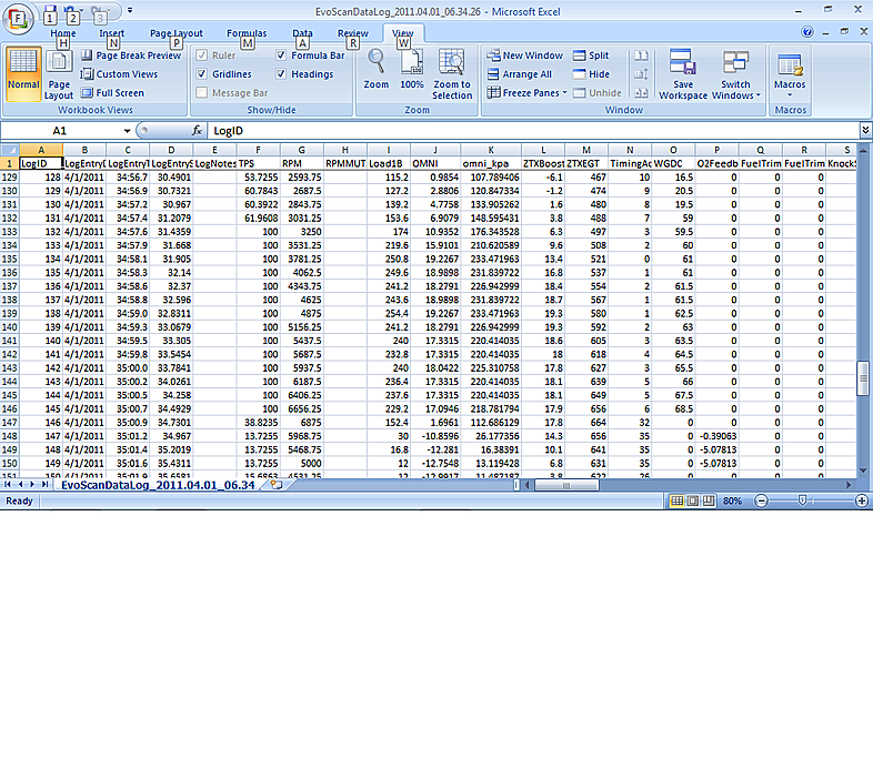

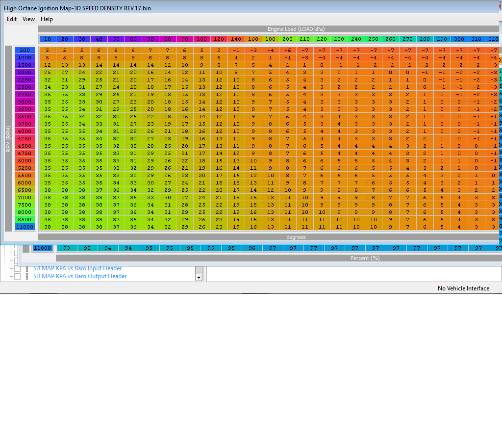

If anyone wants to see what exactly i'm talking about. Here's a copy of my evoscan log...i tryed posting my map also, but it exceeds the file size limit. I'll post up pics of my timing map in a bit.

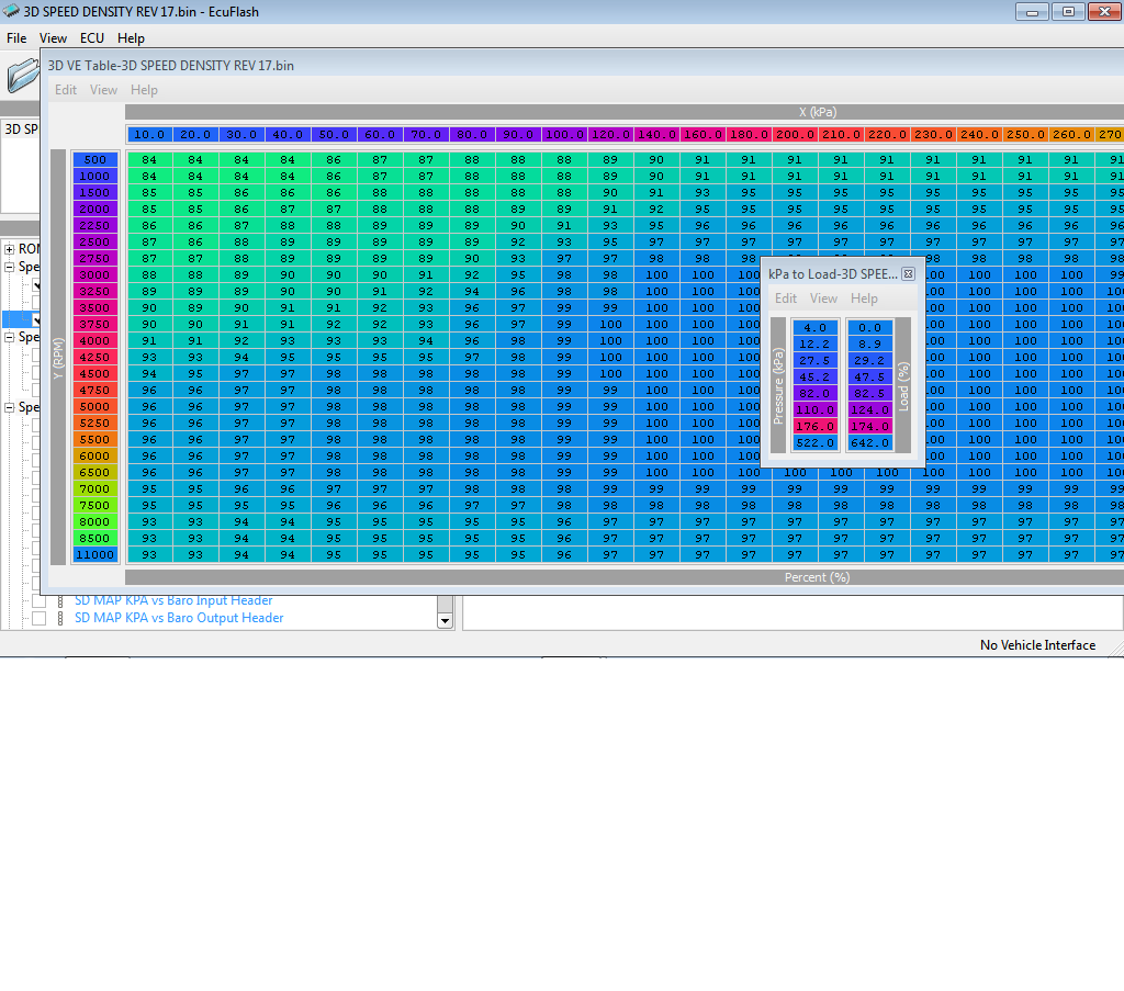

How does your VE and kPa to Load map look like? Post pic of those too. Is your boost about correct in logs (120-130kPa=17.4-18.8psi)?

^yes your right, I posted all the pics including the log just to make it easier. There aren't that many data items because it was only a 2nd gear pull. I was also logging all sorts of stuff to check my trims at the same time which wasn't good as far as resolution. Thanks

Did you datalog your intake temp? There is also reduction table for ign advance as function of intake temp.
IIRC baro&temp compensated load is used for table look up's in tephra roms. Is it now so that by SD calculations we get raw load and that is still modified with value of baro (locked in sd) and intake temp? If it is like I suspect, you would need to datalog baro&temp compensated load to get know what load value is exactly used for table look up as 1 byte load is based to raw load value.

Just to be sure, did you check your Octane Level, was it still 100% (= your car was using only High Oct maps, not interpolating between high/low)?

^Yes I made sure it wasn't interpolating as well, and to be extra sure I made both Hi and Lo octane ign maps exactly the same during the run because it happened a few days ago. I've only recently started to add my timing back.
