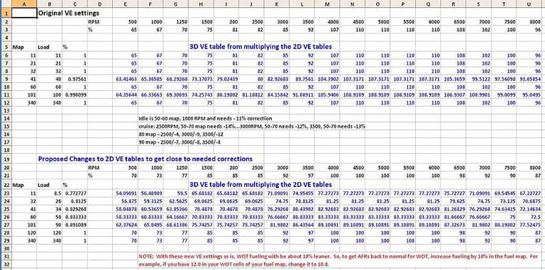

Hi Roadspike !
Thank you the answer ! Yes I'm logging kpa ( x6.895 my omni 4 bar psig readings ) ! My car idleing at 36kpa maybe because the hks 264 cams ?!
So you said to reset my 3D ve tables to stock and first time only playing with Kpa to load table until my windeband afr is close to my high octane fuel table afr numbers 14.7 under 100kpa ?
Under 100kpa and 3000rpm the numbers in the 3D ve table is not extrem high to play with the kpa to load table ? OR these rom is working complety different as the 2D speed density rom ? I ask that because I saw 3D Ve table made from logs what is looks like completly different exspecially under 100kpa and 3000rpm.

Neat chart but the 3D portion of it is not correct. You chart is multiplying the kpa difference from load to the rpm but thats not entirely right.
The correction in the chart which would make sense to change would be the load corrected values.
You could use the RPM VE and see how it suggesting a 70% vs 65% VE @ 500rpm that its suggesting a 7% increase in VE at 500 rpm across all kpa ranges.
Don't use the 3d portion though there just isn't a good way of figuring out the chart from the 2d values. Each cell needs to be individually tracked and thats a better job for evoscan and a custom tracked value for determining the difference between afrmap and wideband vs kpa.
Old Mar 23, 2011 | 11:15 AM
  #193
l2r99gst's Avatar
Posts: 3,499
From: CA
That is the chart I created way back when to create a 3D VE table by multiplying out the 2D tables (jcsbanks 2D SD tables). It multiplies map VE% by RPM VE percentage, which (when I created it) is how John had SD running.

Old Mar 23, 2011 | 11:21 AM
  #194
RoadSpike's Avatar
Joined: Oct 2006
Posts: 3,805
From: Sacramento, CA
