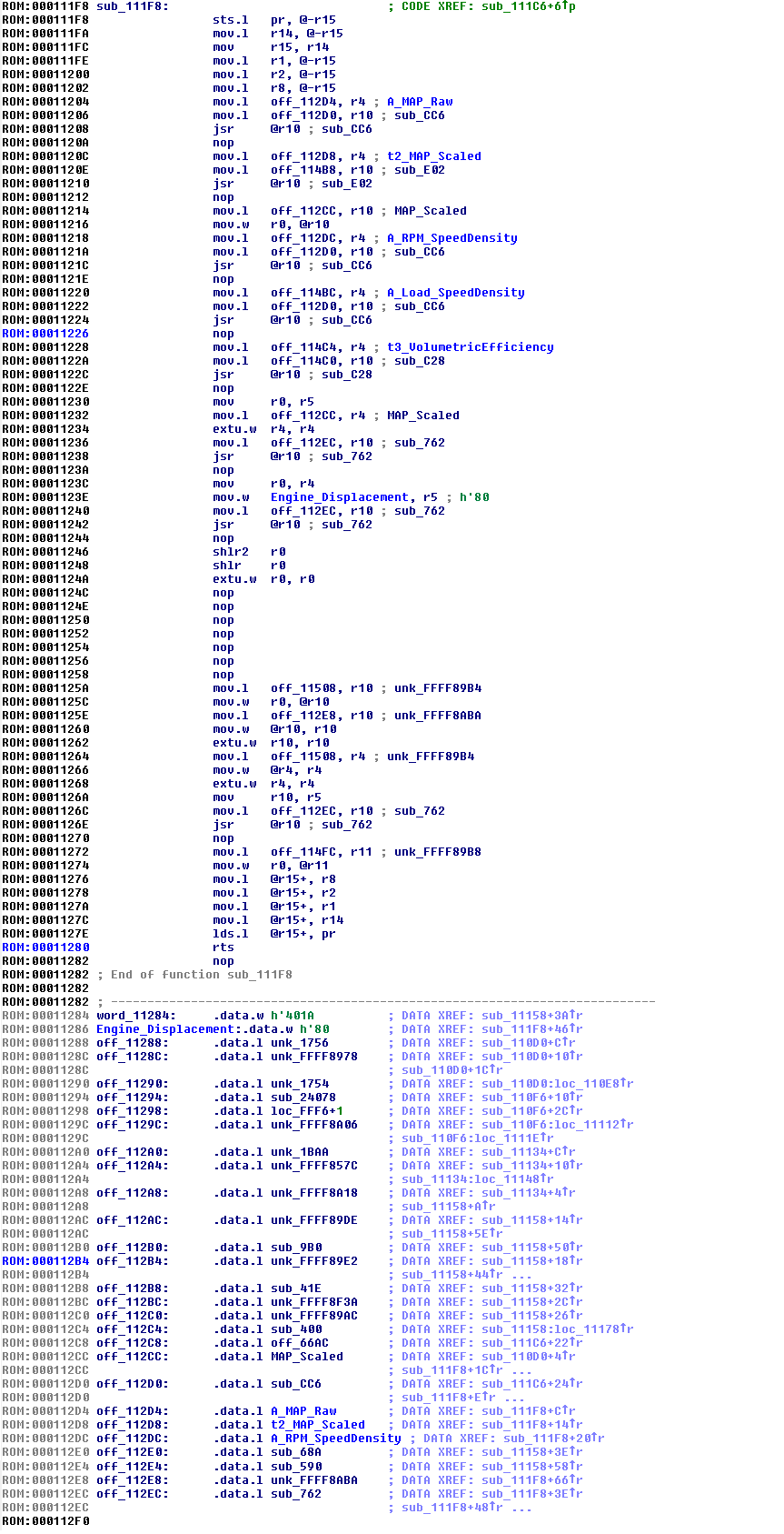

Also, as for an idea, I would highly suggest a slight break in the current methodology. Currently we try to make MAP pressure into Load using a xml scaling parameter that has to be adjusted depending on what MAP sensor you are using. This does a couple things all in one map.
First, obviously it allows various map sensors to be used, however it requires changing xml settings to make it happen. Second, it allows rescaling for engine displacement to take place. For example, if you go up to a 2.4L, you can simply increase VE in this map by 20% and it will compensate for it. Third, you tune MAP based VE by it.
My suggestion is break this map apart into separate functions. Use a MAP-Voltage table to program for different MAP sensors then there is no need to change xml scaling values depending on MAP sensor. This way, ANYBODY can simply take predetermined numbers for a given MAP sensor and plug them in and know that they will be in the ball park right away. Then include an engine displacement variable. Going from a 2.0L to a 2.4L? Simply type in 2.4 into the box and it is accounted for. The MAP VE is then taken care of completely in the 3D table. You could potentially do this for a fuel change as well. Putting in E85? Change this variable from 14.7 for gasoline to the appropriate AFR for stochiometric AFR of that fuel. This of course wouldn't change load, but you could use it as a nice little feature to adjust injector sizing.
Here is what I wrote and how it looks.
https://www.evolutionm.net/forums/8622723-post108.html
The attachment is my code. I used the original MAP-VE table and the MAP calibration table. I used memory addresses 2F40 to 3300 to define my tables.
