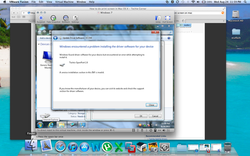

alright, dug a little deeper. This is the error i get when windows fails to load the drivers for the openport

got this from nasoic:
I'm having issues with XP recognizing it as well.
During the ECUFlash install, it installs the OP 2.0 drivers as well so not sure how you get that in WinMobile but..
I get an error and XP doesn't fully install the driver.
Says "A service installation section in this INF is invalid"
Edit#2 - figured it out...I took a 'shotgun' approach - copied my win/inf and win/System32 folder from a laptop with a full install, it recognized it but also asked for a usbser.sys file which I then copied over. Haven't pulled my ROM yet but all seems well.
looks ill be installing ecuflash again on my old computer (that i just wiped because its on ebay). ****
