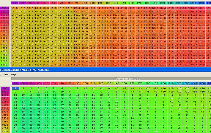

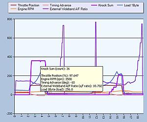

possible bad knock sensor ?
does it quite often, mainly after multiple pulls. after some time it sorts out
nothing strange in the rom in that area. any suggestions ?

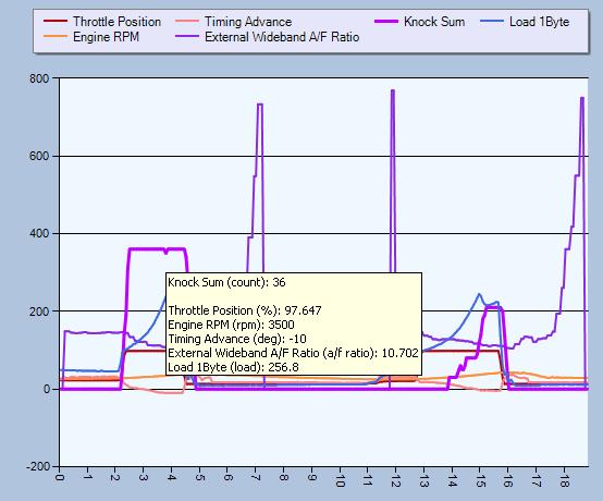

In your pics I see:
knock 36 counts, RPM 3500, load 256.8, Timing -10
If I go to your timing map, I see at 3500 RPM and 250 - 260 load, 1 degree and 0, coming from a -2 and -3 in 3250 RPM
I think you need to increase these values
