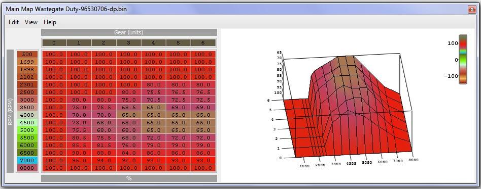

For reference, I've included my WGDC table for my stock 8 MR with a GM 3-port BCS, which should be similar to the grimmspeed.

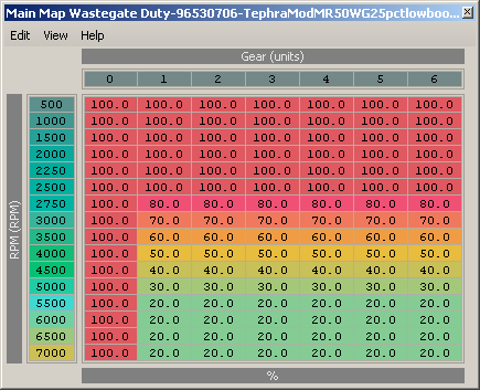

it went well i was too chicken to run anything more than 20% DC above 2750 rpm, had 100% until 2750 on all gears dropping off to 20% through to 7000 rpm. It worked as expected. I will attach the evoscan logs shortly. It spooled up quick and then tapered off quickly after hitting 1.3 bar around 3-4k. I intend to run the settings below tomorrow.
CJ
CJ
OK a few things:
Remember that in 5th & 6th gear you're in the spool-up rev range for much longer so the turbo has more time to spool up and overboost. You'll want to have a lower WGDC in those gears to compensate, and higher in 1st & 2nd gear (if you like wheelspin).
You might notice that I've also adjusted the RPM axis on my WGDC table as that gives me tighter control of when to to start bleeding pressure when I've reached my target boost. This gives me 100% WGDC right up to the moment it starts to overboost and then quickly bleeds it off, giving me a much faster spool up. You'll also want to gradually increase the WGDC towards redline, as you need more pressure to keep the same boost level the higher the revs get.
- Log less things. The cable can only do a certain number of requests per second, so the less items you log, the more of the ones you care about you get. While you're tuning boost you really only need RPM, TPS, WGDC, KnockSum and your MAP sensor. It doesn't look like you've got a MAP sensor though, so you can turn that off.
- Log a few back-to-back 3rd gear pulls from 2000 rpm to close to redline. Try to make it a flat bit of very quiet road (or a dyno). Basically the more data you can get, the better.
- When you increase the WGDC table, do it in small increments (10%). You can do that easily by selecting the cells and hitting * in EcuFlash, then entering 1.1. Once you get close to your target boost, make changes in 1-5% increments (* 1.01 to 1.05).
- Keep a very close eye on your boost gauge and if you start to overboost, back off.

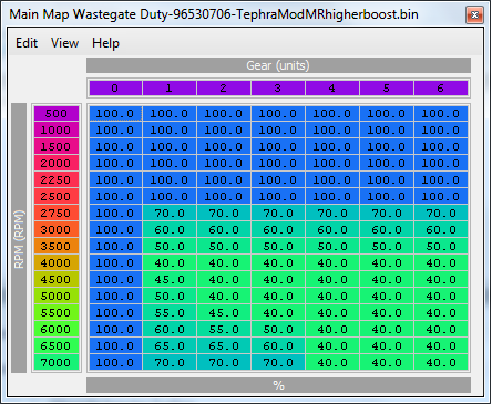

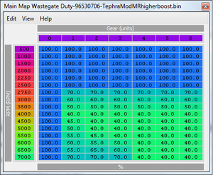

thanks mate, I ended up with a wgdc table which looks like below. It seems happy here but i think i can push these further, will wait for a wb02 before the next run. I now have to put this on the back burner due to other projects and work. Thanks again for your help.
