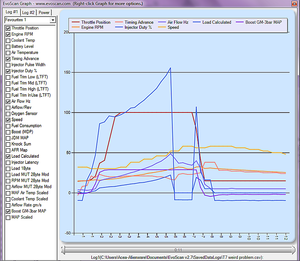

Hi all,
I have a 2001 EVO VII JDM GSR which originally ran the 98640014 stock rom, with this rom i am able to accelerate at WOT to redline with no hassels, as expected. I have downloaded the Tephra v5.10 90550001 rom and payed for the V7 rom as well.
With those two maps i have a problem where if i accelerate at WOT i get this strange cut, and the car bucks back and forth. I have done some logging last night on the stock rom and the Tephra V7 rom.
The results can be found below:
I am leaning toward increasing the fuel cut load x1 values to try and get around this problem. Does this sound like a solution or am i off track?
I am only new to this and trying to learn as fast as i can. I have found this forum very informative.
Thanks,
Acea
Attached Thumbnails Strange TPS related cut problem. Tephra ROMs-stock-map.png   Strange TPS related cut problem. Tephra ROMs-tephra-not-full-throttle-run.png   Strange TPS related cut problem. Tephra ROMs-tephra-tps-problem.png

I have just completed logging several WOT runs back to back. I changed the fuel cut load x1 parameters and nothing changed. All i can tell is that it does not happen until the 3000rpm mark or over. I accelerated past 3000rpm with the TPS not at 100% and then pushed the accelerator to the floor, the problem occured at whatever RPM i was at when the pedal hit the floor.
This has me stumped, i have gone over the new log and nothing seems the same when it happens, other than it occuring around 3000rpm for most runs.
Any ideas?

Attached Thumbnails Strange TPS related cut problem. Tephra ROMs-fuel-cut-values.jpg
