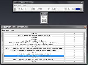

It's in the (FAA) periphery bits section in ECUflash. Just change it from 1 to 0 to disable it to see if it's the culprit.
-Jamie
(aka Jack_of_Trades)
