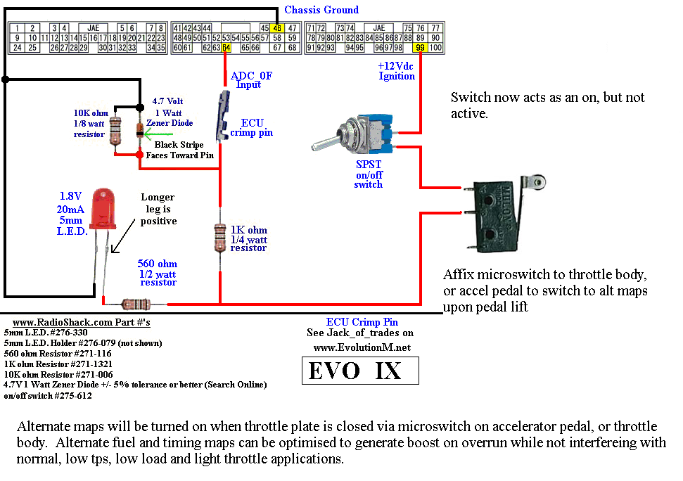

However if we can get 1 timing map from any where to use in the rom, such as EGR timing map, or alt map, or launch map, strictly to switch to when tps is less than an adjustable percentage it would be a huge start to making this evo ecu a little more capable. granted we cant do true idle antilag cyclic etc blah, we or atleast I am not asking for that. Im interested in the ability to hold boost on overrun, for an amount of time which would come from the 8858 sas capable rom. We would be able to use ADC0F switching to switch to alt maps and get fuel and timing too. The possibility is there. We just have to chose a channel to output a set voltage, and when its triggered by overrun condition, or maybe in the 8858 rom it can be switched to the overrun timing map when it goes to sas mode. Somone has to be able to accomplish this. And Im still making it stand that if JB can do it with a USDM rom and use the bcs map to activate, then it would be worth looking into this with a rom that has the adjustability we could actually use!
ecu gods, is any of this other than impossible?
I think I just have to achieve a voltage output from the ecu that dictates when tps is below a certain % that a certain voltage is applied, if I put enough thought into this im sure I could hack it? Then it would switch to alt maps or now "overrun maps" and such.

Switch able ALS is perfect.. yes the EGR timing map mabye a good idea for Antilag timing map with TPS/RPM !
What I never seen on stock Mitsu ecu is capable for Ignition cut..
Here is picture what I posted earlier what is need for ALS :
everything is shouldbe possible with stock ecu as we see what Tephra roms can do ! Only problem with the Ignition cut
The Evo X Ecu is better because the Electric TB is there for air in ALS mode .

So is it the consensus, that having a set of fuel and timing maps that takes effect during overrun would be a best route for achieving boost on overrun? You could have identical fuel and timing map resolution by using either alt maps, or launch maps. Control timing and fuel finitely by load. Thoughts? Im in for 88580714 lol
I am still thinking that there is a way to achieve map switching on overrun with minimal patch work. There must be an internal location we can use to trigger a switch to alt/launch maps based on the current map switching ability of the roms?
given that there is a load stipulation for alt maps, and a speed and tps for launch maps would it make any more sense to focus on using launch maps to create the overrun map based on launch maps vs alt map? I would be ok with losing launch maps because the factory 5000 rpm limiter is already enough to break my 255's loose during a launch.
Let me just emphasize, that I am months away from having my car back on the road because of winter. If I could wait and get an entire parts list from a evo IX, than it would be my preference.

Heres how Im thining to implement alt maps.
Boost at idle is not something I would be worried about strictly overrun/throttle lift situations. I would even have FFS enabled, only to use boost on overrun where the situation would call for a reduction in throttle input. I believe that this feature would be very handy for autocross where the lifted throttle duration is relatively short, and this may be less advantageous for true roadcourse applications because of sustained deceleration. I am not sure about EGT during extened overrun situations.
Nice idea, and the wireing diagram is valid.
Does pin 64 have an internal pullup/pulldown resistor?
No idea i modified jot diagram.
What is the function of a pull up pull down resistor.
This is the most feasable option yet. I need somone to tell me if the 8858 vs 8859 roms share the same adc0f input. thanks!
I can test map switching with the car not even running i suppose. I will order a map switching harness from buschur racing, and just add the switch! In cabin is probably the best idea considering that radioshack switch is likely not weather proof.
