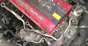

Originally Posted by 211ratsbud
A complete sas exhaust manifold piping canister valve and solenoid would be a good start. I want to ditch my homebrew until i see the shortcomings of oem and modded oem. Lmk evo ix parts.
I found this one

This one is from a 5, but I'm positive that 4-9 have the same SAS, the only difference I found is between JDM & EDM Evos, JDMs have larger diameter bango bolts.
That is not the case the evos with mivec have a specifically different routing to avoid the cam sensors. I would love to have come across a set from a 9... if you can.. or a set atleast from a car with mivec.

Are you sure about the mivec difference? I just browsed several pics for comparison & they all look identical, mivec & non-mivec with sas piping passing top of the cam sensor at the corner.

I have seen the difference noted in several threads on here about SAS hardware from people that have imported them. I could make it work without a doubt, but i was looking for a proper fit. The braket that mounts the SAS valve is slightly different. Again, nothing huge that couldnt be tinkered with. However I would feel much better about having the proper gear model type parts, for fitments sake
