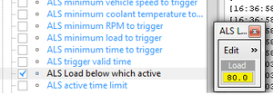

maikumaru, this is the load below which active table i was speaking of. I think that it could be raised so that the system activates while falling and activates from a higher point.
I think it's the otherway around, stock setting is 80 which means sas would activate at 80+ load. For ALS, sas should activate at much lower load value, that's why with pops'n'bangs I used a lower value such as 45. P'n'B are ain't no ALS but at least I knew that sas got active at lower loads,in between shifts when hearing the bangs.
Old Jun 1, 2012 | 04:30 PM
  #324
Maikumaru's Avatar
Posts: 286
From: Laguna Hills
[/QUOTE]maikumaru, this is the load below which active table i was speaking of. I think that it could be raised so that the system activates while falling and activates from a higher point.[/QUOTE]
Right I am very familiar with that.
I think I understand your idea...Higher load/ ie meaning more air shoved into the ex manifold on throttle lift.
however you might not be 100% understanding the use of that table.
It comes down to what you want...you could put max load as criteria...but that means it will only activate when you lift off after max load.
my criteria is very low...so it activates throughout rpm range and throttle application/throttle lift off.
if you want air pumped in only when you have given 100% throttle etc, that is your choice. It wont make a difference...your upper IC is not going to hold extra air etc.
if I apply max load while driving to the throttle and lift off...the thing goes crazy. At the track it is really really nice.
but is also nice when I give 25% or 50% throttle and then lift off...
mine is always on...
with stock ecu, your foot controls the effect of the ALS etc.
get yours up and running first, and then we can compare.
